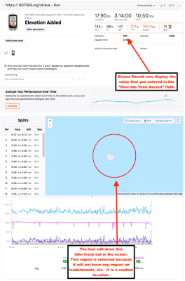

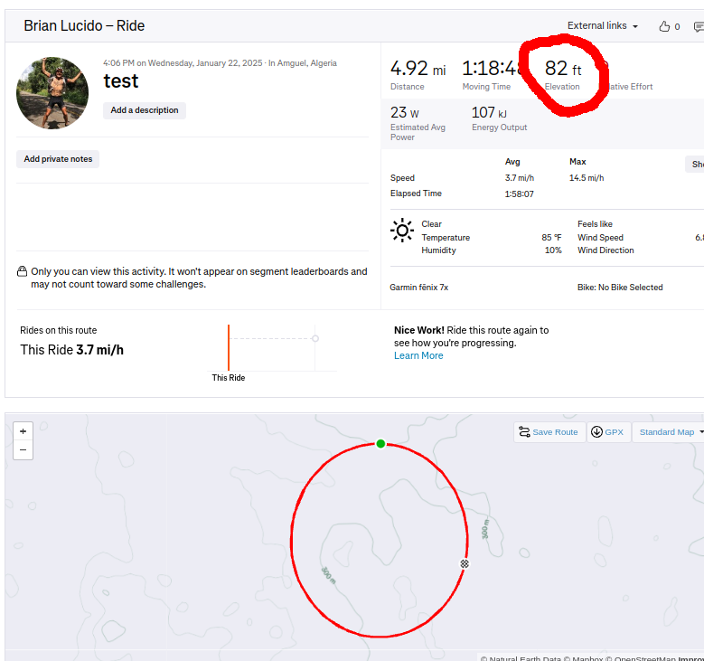

If you check the "Make Fake Track" box, by default, the tool will create a track which is a 1 kilometer circle out in the South Pacific. You will continually go around and around the circle, depending on how much distance you accumulated in your activity. The elevation plot will be flat if the elevation is missing from your file, but you can now enter a number in the "override elevation" checkbox to get a total ascent value in your final file. You also have the option of uploading a custom GPX file to substitute and back-fill position data for your GPS activity file.
Here is what it will look like if you use the circle (default) method:

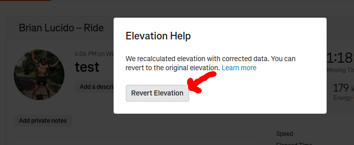

How to fix if Strava did not respect your elevation override
IMPORTANT NOTE!! Even after using GOTOES Elevation Override, Strava Might Override Your Elevation Anyway!
Step 1: Go to the 3 dots and select "Revert Elevation"
Step 2: Cliick the button that says "Revert Elevation"
Step 3: Now you will see that Strava will display the GOTOES assigned elevation. Strava is always eager to override your elevation, so this is how you can overcome that.
