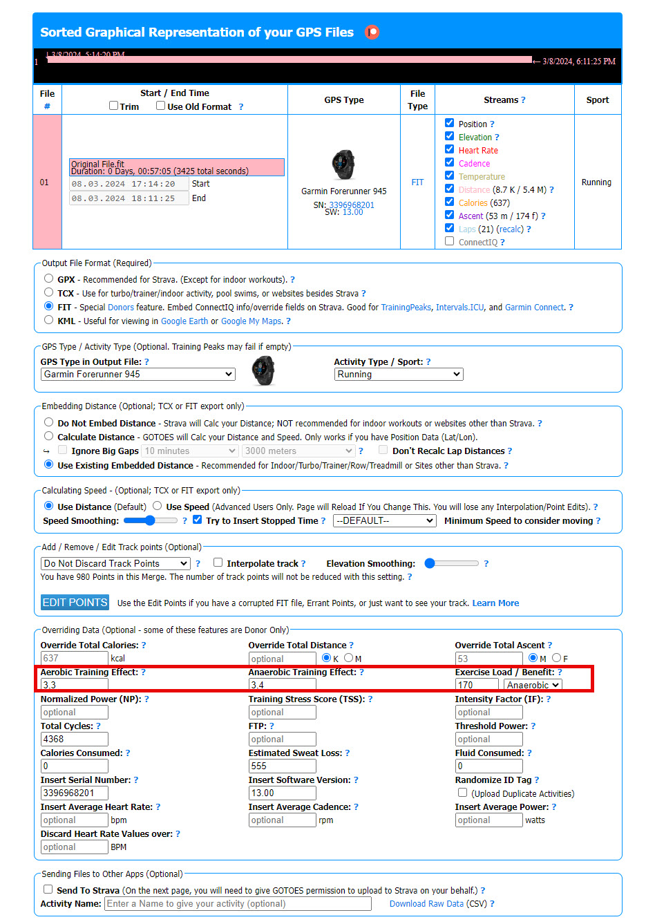

when I try to upload a FIT file to that I edited in GOTOES to GARMIN CONNECT, all values are accepted in GARMIN CONNECT except the following:
- Anaerob Training Effect
- Aerob Training Effect
- Exercise Load / Benefit

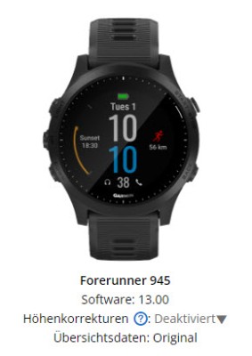

I already checked that my Garmin Device (FR945), Serial Number and Software Version (13.00) are included, which is the case.
I also do see these values and my watch in GARMIN CONNECT, but it still does not take over the 3 values from GOTOES.
Instead of that, it keeps the original values.
I noticed that the Software Sersion in the GOTOES FIT file is always set to 13.01 instead of 13.00.
So if I put in Software Version 13.00 / 12.00 / 11.00 / ... GOTOES always sets it to 13.01 / 12.01 / 11.01 / ... in the FIT File.
Could this be the reason why the values for training effort etc. are not accepted by GARMIN CONNECT?

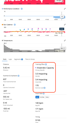

Re: Garmin Upload - Training Effect & Benefit does not work
The current solution to this problem is indicated below. I will persevere the historical posts as well so you can see how we came to this resolution. I will update the post if we figure out a setting in Garmin Connect that disables this auto-correction... or if Garmin agrees that this is a "bug" that needs to be fixed.

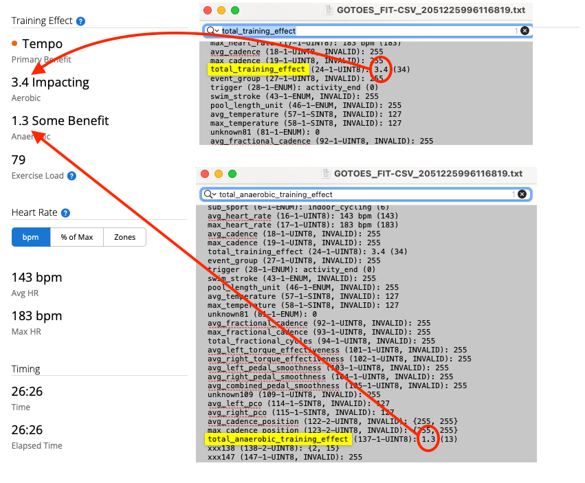

It is natural to be suspicious, so GOTOES offers a diagnostic tool that spits out all of the raw data contained inside of your file. You can upload any FIT file to this site:
https://gotoes.org/gotoes/strava/conver ... to_csv.php
Be sure to check the "Messy Dump" option so you get a diagnostics file:
After you download the diagnostics TXT file, open it with the text editor on your computer and search for these two fields:
The number you are looking for is the number just before the parenthesis (or you could take the number in the parenthesis and divide by 10).
You should notice that in your original file, and in the GOTOES export, the values for this field are correct.
total_training_effect
total_anaerobic_training_effect

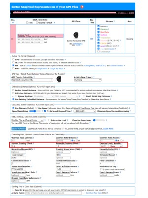

thanks for your qucik reply!
Attached you will find some screenshots and the 2 fit-files (one original from Garmin and the one editetd with Gotoes).
As you will see, I´m able to upload the edited fit-file, but the Training effect fields are not overtaken (but weirdly they changed anyhow).
The issue with the software version seems to be fixed already.
Thanksa and best regards,
Daniel
Daniel

- Garmin Connect - training effect fields in original fit file
- Garmin Connect - original - training effect.jpg (18.61 KiB) Viewed 40991 times
